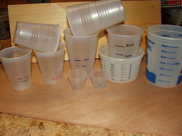

If you don’t have access to a lathe, simpler, 8-sided handles can also be made, fitting the ferrules using rasps and files.  Using thickened epoxy demonstrated below to mount the ferrules; the fit doesn’t have to be perfect, as the epoxy will fill those gaps perfectly.
With the handles turned and ferrules mounted with epoxy, I drill the final .25-inch holes with a jobber bit that will follow the pilot hole neatly in preparation for installing the blade mounts, also using epoxy.
